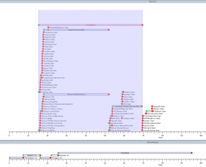

yes, rightclick and select "Summary table". The green is ok. this is ReadyBoot which writes the prefetch data back to the HDD.
Not really sure why avg shows up, as I dont have it set to start at boot, soluto appears to use alot so maybe I should remove that from the startup.
Im not really sure how much is normal usage for the system processes, maybe you can determine anomalies from the screenshot... the top 28 of 45 are included

remove AVG and Soluto. Also expand the SYSTEM entry and look which files the system accesses.

Your Windows takes 25s to boot to the desktop and 45 to boot completely.
your 5400rpm WD HDD is the bottleneck. The prefetcher does its best to improve it. What I can see is that apache takes 13s to start. Set the start-type (also for MySQL) to "on demand" and start the 2 services after you booted completely to the desktop with (NET START Apache2.2, NET START mysql. looks like you use XAMPP, correct?). Also the Intel Management service (IAStorDataMgrSvc) takes 5s to start. This happens during the time where your HDD is completely busy.

Indeed I have xampp, I changed both mysql and apache to manual start, and ran the trace again for 6 runs.
I timed the boot to the desktop with a stopwatch on my phone, takes 35 seconds to desktop, which is excellent considering it took about 3.5 mins before I started optimizing...

before the optimization your Windows booted in 117s to the desktop and now in 25s!!!
Open the bootPrep_BASE+CSWITCH_1.etl and look at the ReadyBoot graph. All was black. Totally broken!
post-70718-0-00289100-1319030095_thumb.p
The optimization improved it a lot.
After the optimization the start of some services is still slow:
In your case Avast! AV which takes 33s to start.
avast! Antivirus" group="ShellSvcGroup" transition="start" totalTransitionTimeDelta="33906"
and the this Autodesk service:
="Autodesk Content Service" group="" transition="start" totalTransitionTimeDelta="15232"
post-70718-0-56887500-1319030425_thumb.p
So try a different AV tool and look if you need the Autodesk service.
