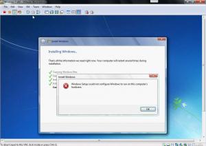

I never got this (method 5) to work for Windows 7 SP1 x64 Ultimate English. Just tried it again, I get a message during Windows Setup "windows could not be configured for your hardware" or something like that.
Not going to try method 6 (rtlite only) since updates are not going to work completely according to earlier posts.
--> It works when I test my RT7Lite image (call it iso 1).
--> It also works when I test my RT7Lite image after doing Apply & Capture with ImageX (call it iso 2).
It does not work when I test my image after doing vlite on the iso 2 (call it iso 3).
see screenshot attached.

Posted (edited)
did u try on original iso and with my ini and inf ?
did u intergrade something ?
Edited by aviv00
I did not integrate anything. I use your ini and inf (sp1_v2) but I keep some stuff you selected. For example Japanese language in vLite is selected (needed for Office 2010) and Windows Mail is selected (needed for Office 2010) and a couple of drivers and other stuff. I do select other things like Wordpad, Write and Paint.
But I really dont understand whats happening, Just tried the entire process again. When I want to apply the changes in vLite, it asks if you want to "apply for current image (HOMEBASIC) or all images."
I have Ultimate! Why does it say Homebasic suddenly? In RT7Lite I applied changes for ALL images (normally I only do Ultimate). So i dont understand.
Perhaps it has something to do with the names I set in ImageX (when capturing you have to fill in name/description twice).
Posted (edited)
Here are my ini/inf files. I used your sp1_v2 and modified it to my needs. It shouldn't make such a big difference right?
I get the error message I posted above.
setuperr.log says something about cmiadapter\installers.cpp not found and a file that is suppose to be in windows\winsxs\.
Perhaps I should just do method 6 (just select winsxs for removal in RT7Lite, don't use GimageX and VLite but not sure wich updates will work and wich won't work..
