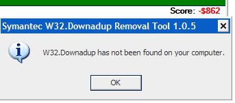

Tripredacus Posted June 15, 2009 Author Posted June 15, 2009 I'll bet nothing but I will point out that Conficker for example would punch right through thatUmmm.... what is this: O10 - Unknown file in Winsock LSP: c:\windows\system32\nwprovau.dll Oh don't get yer hopes up yet, that file is simply "Client Service for NetWare Provider and Authentication Package DLL"... Rootkit Revealer came back with 12 discrepancies. They are all the "Key name contains embedded nulls" and one "Data mismatch between Windows API and raw hive data", which under most circumstances means absolutely nothing is wrong. But its funny that Conflicker was brought up. Its appearance was the number one reason why I had this thread idea going around in my head. When Conflicker came out, I was still on SP1 with no updates, other than my hacked USB 2.0 functionality. I am on SP2 now (as noted) but even a repair install wouldn't have removed it on me. Alas since the last test passed as far as I am concerned, I'll move onto the FixDownAdUp.exe from Symantec. And while I was waiting, I've been playing Solitaire, because being productive is key amongst us business types. I am playin 1 card vegas and sitting at a healthy score of -$26.
