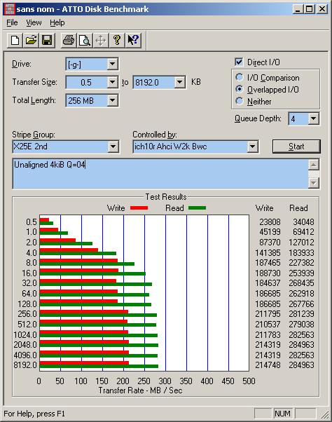

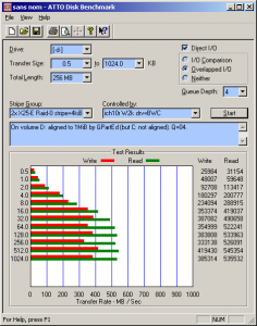

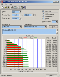

pointertovoid Posted May 24, 2011 Author Posted May 24, 2011 Here's the kind of performance obtained with Blackwingcat's driver - as good as the XP driver, or even better!An Intel SLC SSD: 30GB X25-E, on an ICH10R host, measured here by AttoDisk with Q=4.And now, a Raid-0 of two X25-E on an ICH10R, again with Blackwingcat's driver.this was with a stripe size of 4kB and an Ntfs volume aligned on megabytes, created by GPartEd.Measurements by IOMeter are equally impressive, especially if its accesses are aligned on multiples of 4kiB for the Raid - not really cheated, since this is the cluster's size. On a single X25-E disk, alignment of volume or accesses brings nothing - as this disk is already a Raid over 10 channels, not 8 nor 16.In both cases, an F6 diskette made with this driver was able to install W2k on the disk or group - but only if the first volume was created by the W2k installation disk, not by GPartEd.Well done, Blackwingcat!

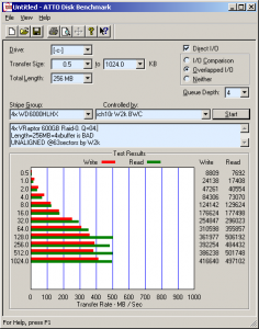

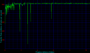

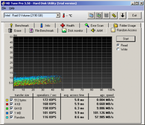

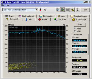

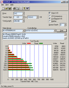

pointertovoid Posted June 10, 2012 Author Posted June 10, 2012 I bought four 600GB Velociraptors - the fastest Sata mechanical disk as these used parts were, errr, less expensive than usual Notice the arm's speed, much improved at the 450GB and 600GB series. And, with the driver ported by BlackWingCat to run the ich10r, they ruffled my hair Don't trust Atto's maximum throughput too much, since the VRaptors have 64MB buffer each and this version of Atto tests over a 256MB file... WinBench99 must be more accurate, as usual. Anyway, aligning Ntfs to 1MiB boundaries did improve Atto's results BUT W2k installs only on the volume it created, at sector 63 I suppose.Also interesting: the group exceeds 2TiB which W2k can't handle directly, but with Intel's Matrix Raid Bios (recent enough!), I could define two pseudo-disks smaller than 2TiB each, and only then it seems to work. That is, 2k wouldn't install at all in >2TiB, but by slicing the group, it did; I was lecherous enough to create the second pseudo-disk at around 2TiB distance from the Win volume and overlapping it, and a slow format of the higher volume didn't destroy the lower volume. So at least for Raid groups between 2TiB and 4TiB, this would be a solution.They didn't start W2k (F6 install easy) appreciably faster than a single VRaptor does, and certainly slower than my X25-E Ssd , but they allow to browse folders of uncompressed pictures very quickly, and are excellent at launching games - where Ssd don't have the capacity.Well done, BlackWingCat!
tomasz86 Posted June 10, 2012 Posted June 10, 2012 Very nice access time Better than mine (6.2 ms) on a SAS 15 000 rpm drive.
