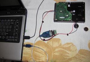

CarterInCanada Posted April 25, 2009 Posted April 25, 2009 Sorry I'm on the other side of the continent trgTyson otherwise I'd loan you my setup. The crucial bit (the serial-to-TTL adapter) I grabbed was from right next door to you in Quebec at RobotShop. Might be just as easy to get a mail order headed your way. The process itself is simple, you can handle it I'm sure. Since I've already gotten a couple PMs asking for it again, below I quoted my post from a couple days ago with the link to my particular episode of disc un-bricking within.Good luck, we Canucks have to stick together!Cheers, CinCHullo folks out there in bricked drive land! Just reporting another success in the method for a pair of 1TB (ST31000340AS) drives. I've read most of the various threads on the net and managed to muddle through with a mix of them all. For those of you that may be a bit less technical (I'm not far behind you), I detailed my procedure in simpler terms for a friend in the same boat down in the States who was terrified of the whole process. It wasn't the cheapest or easiest path and probably took a few extra steps/parts but I do think it simplifed (and filtered) a lot of the other instructions out there for some of the technically challenged (which as I say, I'm not far behind). If you'd like to peer at my method and results, you can do so at http://www.mapleleafmountain.com/seagatebrick.html , the page I created on my own site. (I promise, nothing is for sale there) There's a whole new crop of pictures and yet another digest of the instructions. I'll keep it up as long as the bandwidth doesn't go nuts.Thanks to everyone here that helped me understand and get my drives back. Cheers!- Carter
