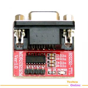

I was wondering if my problem could be because I plugged my (RS-232)-to-TTL adapter with the 5V red cable from a molex plug.
Someone knows what I'm doing wrong??

you might need a 3.3V converter, see Read-Me_First, http://www.msfn.org/...610#entry922610 Point 10 will explain in more details
Also, did you connect ground? (Point 7)
This is my (RS-232)-to-TTL adapter : http://www.robotshop.ca/sfe-db9-rs232-shifter.html
Thanks
Maybe there is a omission in:
The smallest and easiest to use serial conversion circuit in the market! The SFE RS232 Shifter SMD is powered from the target application and can run at any voltage! That's right - power the board at 5V and the unit will convert RS232 to 5V TTL. Power the board at 2.8V and the Shifter board will convert RS232 to 2.8V CMOS TTL. This will allow a microcontroller to communicate with a computer.
Try reading it as:
... power the board at 5V and the unit will convert RS232 to 5V TTL. Power the board at 3.3 V (an Orange cable on a PC power supply) and it will convert RS232 to 3V. Power the board at 2.8V and the Shifter board will convert RS232 to 2.8V CMOS TTL.
Had you actually READ the read-me-first:
(point #11)
11. POWERING the converter (or data cable):
The converter (or data cable) is an active component and needs to be POWERed.
Some converters draw power from the "PC side" (RS-232 or USB bus side). <- in this case you need NO external Power Supply.
Some converters draw power from the "other side" (TTL side). <- this means, that since on the TTL side you will connect to the HD, you will fall in condition below.
Some converters need an external Power supply (a FULLY CHARGED battery will do).
Generally speaking supplying 0V and +5V will work.
Most adapters will work with as low as 0V and +3V.
A single 3V battery or two common 1.5V may do in the latter, but ONLY if they are FULLY CHARGED/NEW, if they fall below 2.9 or 2.8 V it simply won't work.
