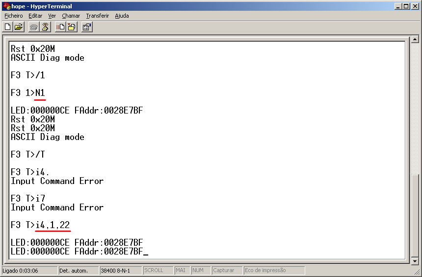

netxare Posted September 26, 2010 Posted September 26, 2010 (edited) First of all, my humble thank you to all that are really trying to help each other with all the knowledge available from sources I can't even dream to discover or be able to find, since English is only my 2nd language - basically, it lifts up my spirit to see such a community.A bit of my archaic past experiences: In the past I've putted in place a simple solution that worked at clients I've worked with ... just replace the PCB with an equal one from another drive available, connect it, withdraw the data, return the PCB to it's original drive and just bang the faulty drive to oblivion.But this time it's personal. It's videos and photographs of my life, it's part of my portfolio as a freelance webdesigner, school memories, etc..At a time of change, where I'd seen friends DVDs get fungus that ate the middle layer and made it useless and with GByte / Euro being more cheaper in the form of HDDs, I decided to store and only plug-in this external drive often enough as needed to mostly input more data, or withdraw when needed, functioning mostly - as you've guessed - my all-time backup "system".Moving along and getting to the point that brings me here... with a good friend that works with electronics almost all the time, we've learned in this thread how to try mend what Seagate has created as faulty. Early this year, my Seagate 7200.11 1000GBytes ST31000333AS firmware: LC15 drive that I'd purchased almost 2 years ago in the form of an LaCie external drive, just stopped working properly.What's the first suspect hypothesis according to the sound it provides? Reading-heads are not being commanded properly. So as in the past I would be trying to replace the PCB and moving on ... but this time I can't find such a drive, and I've searched all around Portugal's forums and what not.Anyway ... apparently and mind you this is and uneducated guess, there's something really wrong with the ROM or ROMs on my drives PCB ... because all commands I type came out with an error that appears to be an indication in form of a memory address where there's an instruction that make it stumble.I know - I also try to guess every week to get the EuroMillions contest in order to pay some freak to just restore my hard drive and get over it.I beg for help, 'cause I already got the confirmation from the retailer that sold my this hardware that is going to due the waranty at the end of this year, that they don't know if when sent to repair, the drive will be replaced altogether or just repaired and format.If the second was the case, I would not be much worried 'cause I would use Recuva or Spinrite and just get the data back ... but I know that most cases they just give you a new piece of hardware and that's that.So please, check out this prinscreens I've captured in my Hyperterminal to learn if there's hope for me.Again, THANK YOU.1. http://pixxtra.com/i...8975/909825.png2. http://pixxtra.com/i...76/56247594.png3. http://pixxtra.com/i...977/5463559.png4. http://pixxtra.com/i...78/51586038.pngOr see the attached files to this post. TnxPlease note that the attached images are "reverse" positioned for viewing - can't change that now :/ Edited September 26, 2010 by netxare
BlouBul Posted September 26, 2010 Posted September 26, 2010 (edited) 4) Undo loopback connection. Connect RX (adapter) to TX (HDD) and vice-versa. Connect GND between adapter and HDD. Plug in SATA power to HDD and press CTRL-Z in terminal.Step 3 is successful every single time, but I fail to progress past step 4. Ctrl-Z never brings up a prompt no matter which client I use and how many times I switch RX and TX connections.Hi Mapex,Welcome to MSFN You have describe in detail the converter setup (which sounds right, especially the successful loopback. But you have not said anything about the Hdd. Did you manage to disconnect the PCB before trying the reset?I've also tried connecting a CR2032 battery to the Vcc and GND ports of the adapter while maintaining the common ground connection between adapter and HDD, but that hasn't done anything either (and I'm not sure it would because the adapter is USB powered anyway).The adapter is normally USB powered (but not always). The link doesn't say if the supplied voltage is 3.3 or 5V. The 3.3V normally works better. Do you know what the supply voltage is?See also Read-me-First Point 10&11Edit: Sorry, see now it is LBA0- shouldn't need to disconnect PCB. Edited September 26, 2010 by BlouBul
BlouBul Posted September 26, 2010 Posted September 26, 2010 Hi netxare,Welcome to MSFN So as in the past I would be trying to replace the PCB and moving on ... but this time I can't find such a drive, and I've searched all around Portugal's forums and what not.NO!!! Never try a PCB swap with these drives. It won't work and besides that, you can damage both drives.Your hyperterminal commands look funny. It seems some are missing, and others are different. Please try the commands EXACTLY as given in this guide: http://www.mapleleaf...agatebrick.htmlI beg for help, 'cause I already got the confirmation from the retailer that sold my this hardware that is going to due the waranty at the end of this year, that they don't know if when sent to repair, the drive will be replaced altogether or just repaired and format.If the second was the case, I would not be much worried 'cause I would use Recuva or Spinrite and just get the data back ... but I know that most cases they just give you a new piece of hardware and that's that.If you read a couple of posts back on this page, you will see this:What normally Seagate does is:get drives to be refurbishedrefurbish drivesSince they have NO obligation whatsoever about your DATA they will (99% probabilities):put your drive on a stackget ANY drive from the stack, check it, test it, refurbish it, REALLY low level format it, install to it the new firmware, apply to it a "refurbished label", send it to youIf you obtain that your drive is treated (Free of charge) by their Data recovery division i365 they will (99% probabilities):get your drive on a stackget your drive from the stack, check it, test it non-destructively, make sure your data is readable, apply to it the new firmware, make sure your data is readable, send it to youThat means that normally if they format your drive (and even if you can get the same drive back), you won't be able to recover anything. If you can't get them to do the data recovery, it is better to do it yourself if you want your data back.
