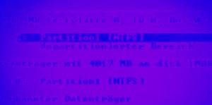

what i meant by partition1 is: my screen looks exactly as that on the screenshot, when i am in that textmode, only
the first entry in the list is C: Partition1[NTFS]
THis is HDD 0, ID=0 Bus=0 (on iaStor) [MBR]
Edited by BdN3504
If you cannot figure out how to amend BOOT.INI just post here your current BOOT.INI on the USB stick.
Take a picture of the partition screen during Text mode setup, post it here as well.

i don't have a camera right now, so i used my s***ty cell phone:

I have only one single partition on the harddrive. you can see that in the screenshot. there somehow remains some 8 megs on the hd which i cannot incorporate into the partition which rests unallocated. but there is only one partition so that should not be the problem.
