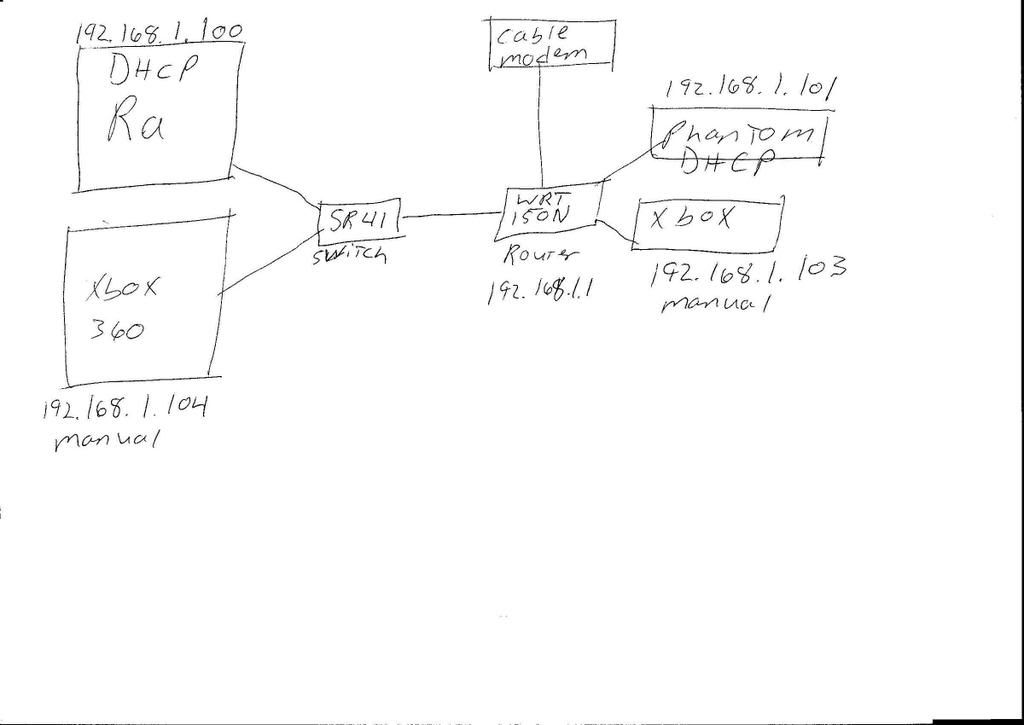

uid0 Posted January 5, 2009 Posted January 5, 2009 I think we need to see a network diagram, and some IP addresses.
Brando569 Posted January 5, 2009 Author Posted January 5, 2009 (edited) hopefully everyone can understand this, if not ill remake it using the computer. i just remembered there's an "uplink" port on the BEFSR41 but i forget what its used for. Edited January 5, 2009 by Brando569
Ponch Posted January 5, 2009 Posted January 5, 2009 That's maybe because your router is trying to be DHCP as well, and its own adress is out the range of the rest of your network components.
Brando569 Posted January 6, 2009 Author Posted January 6, 2009 the BEFSR41 apparently had the same IP address as the WRT150N but i dont see how that could have worked correctly. Either way the BEFSR41 is dead, its been crapping out every few days since i bought it off of ebay and it was getting really bad.... so i beat the crap out of it with a hammer im going to buy a switch and make it simple, thanks for your help everyone.
Ponch Posted January 6, 2009 Posted January 6, 2009 If you put 2 devices with the same IP on the same network and they are both playing DHCP server and "some stuff won't work,... maybe the problem is not hardware ?
uid0 Posted January 6, 2009 Posted January 6, 2009 Once you're down to a single DHCP server, also make sure any manual IP addresses that you've set are outside of the DHCP range.
