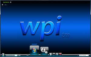

Here are the 3 modified themes that use my euDock. In wpi.htm you will find some new lines at the top:
 DockType=11;  // 11=Horizontal, 12=Vertical
DockLocation=2; // 1=Up, 2=Down, 3=Left, 4=Right
// NOTE: Docks are ALWAYS centered horizontally and vertically.
// They can NOT be, for example, placed in the bottom left corner.
// The ghost eyes work only in Horizontal mode
You can now make the dock:
  • horizontal and located at the top or bottom
  • vertical and located at the left or right
They can NOT be placed at the bottom left corner, they will ALWAYS be centered.
The ghost eyes only work in horizontal mode.
Until Kel gets them updated on the WPI site, here are the links:
http://www.internetepicenter.com/Vista.rar
http://www.internetepicenter.com/mritter_eudock.rar
http://www.internetepicenter.com/spoof_eudock.rar

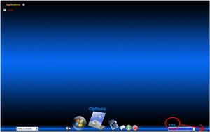

  • Author
Hi Mritter,
As I said, I was playing a bit with the Vista theme and the themes you have mentioned aboved. One observation; the theme made by spoof i.e. spoof_eudock does have the tool tip enabled however once you see the tool tip for an application, the mouse hovering effect is being lost for all the buttons (i.e. congig, install, options etc mouse hovering is not working). What could be the problem?
And attaching the snapshot of my custom theme (obviousely inspired by the above themes). Do you have any idea how to place the count down timer alongside with the time bar (Pls refer the attached snapshot right bottom corner)?
Thanks,
pokemon

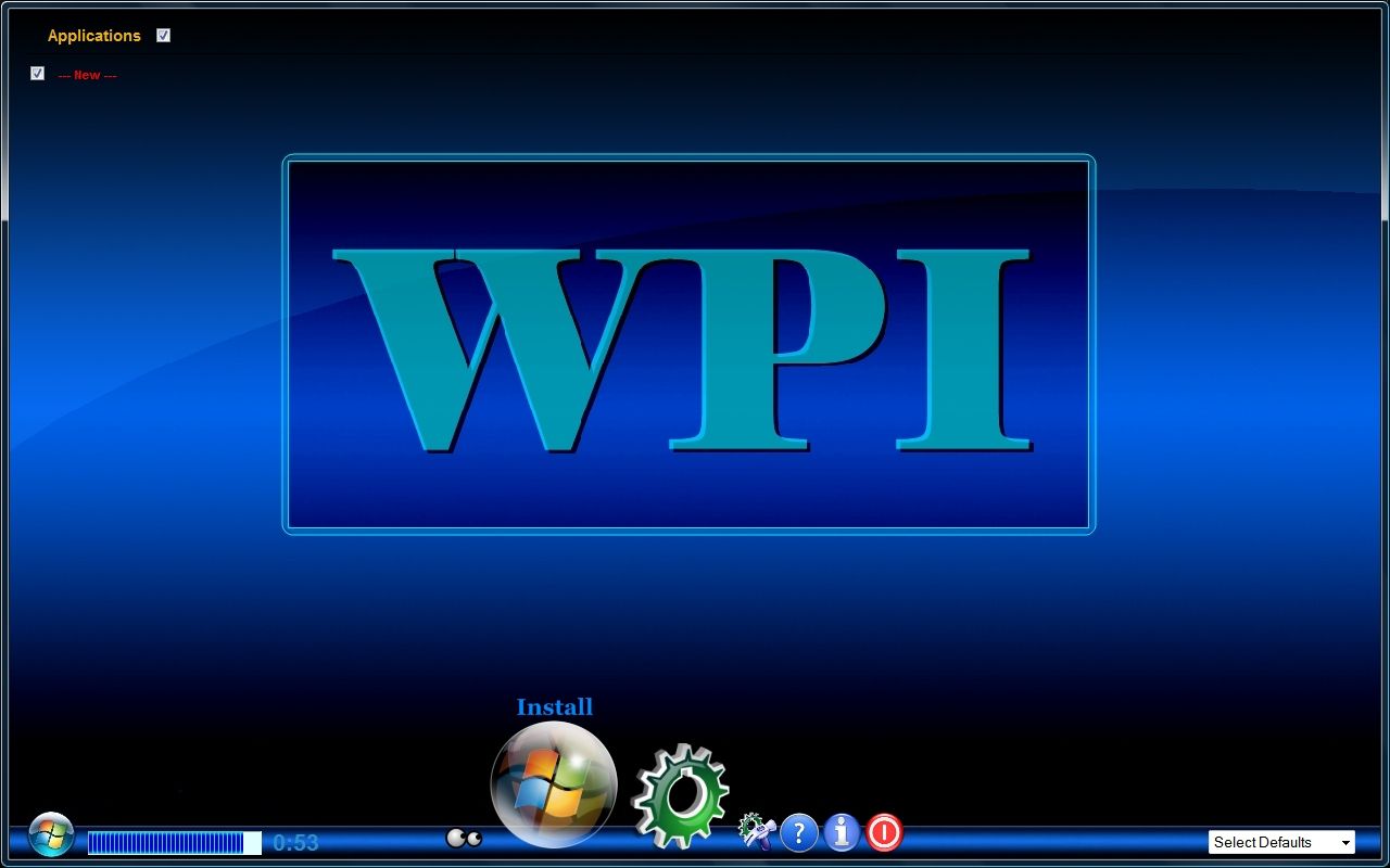

  • Author
Hi Mritter, many thanks for the help with the timer....
I completed the theme and uploading it here now. I have put a WPI logo in the main background (Tried to make glass effect however could not give much time to work). Hope everyone would like it.
Download link: http://rapidshare.com/files/122230212/Vist...timate.rar.html
Theme Preview given below;
Thanks,
Pokemon

  • Author
Thanks Kel. Apologies for any issues you have found. The theme is best fitted in 1280x800.
Better to disable the tooltip. Enabling tooltip will break the mouse hovering effect. This has been discussed with Mritter in this thread. I will try to fix those as soon as I get some time. Thanks anyway.
Regards,
Pokemon

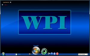

  • Author
Hi Kel / Mritter,
Please find below the updated Vista_Ultimate theme.
Link: http://rapidshare.com/files/123393549/Vist...timate.rar.html
Would request you to replace the same with the one you have uploaded in official theme
site. It works with all standard resolutions however best suited for 1280 x 800 (widescreen) and over. Scrollbar issue is fixed now.
2 known minor issues mentioned below; Can you please help me to solve these??
1. It is preferred that tooltip is disabled while using this theme as it will break the eudock mouse hovering effect. But all functionalities are intact.
2. When clicking on Manual, it starts multiple nos. of same wpi manual sites. No clue about this.
Request you to test and give feedback if any other bug is found. Attaching a snapshot aswell for preview purpose.
Thanks,
Pokemon
