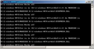

ctpooon Posted February 7, 2008 Posted February 7, 2008 (edited) Nope. Test first.Anyone?tested again. working on both of my machines.have a look in your d:\1-windows-NT4 to see if there is any *.*_ Edited February 7, 2008 by ctpooon
fdv Posted February 7, 2008 Author Posted February 7, 2008 ctpoon, thanks, but the program only loops forever, and does the same file over and over, and never actually produces any output. No idea why.Xperos eXPander - Google search, MSFN search produce no resultsjcarles Compression bin - relies on framework (but I gotta install framework anyway eventually I suppose).ctpoon, BTW, does your name mean you are fond of ladies in Connecticut?
