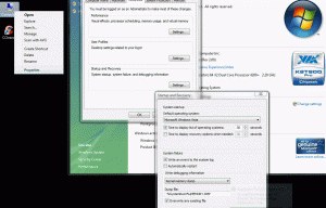

kartel Posted January 9, 2008 Posted January 9, 2008 (edited) You can go safe mode?uncheck auto restart.I had a few updates yesterday, then overnight I got another and when I rebooted, I think it had a brain fart and rebooted again, but I caught it when I wasn't looking so I cant be sure.I friggin hate updates sometimes.... Edited January 9, 2008 by kartel
