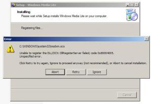

I'm experiencing this topic's problem, but WMLite 2.40 didn't resolved. In my Windows XP Pro SP3 Nlite Pack I removed WMP, WMP6.4 and selected NoWmpComp. But when I try to install WMLite to use along with MPC, completing CCCP-Project, I get the error message attached and partially reproduced below:
C:\Windows\System32\msdxm.ocx
Unable to register the DLL/OCX: DllRegisterServer failed; code 0x80004005.
Unspecified error.
I'm having some similar problem when trying to install Titou2k's pack WMLite10 2.1.0.3, none of the files can be installed.
I already searched over MSFN and Internet for an answer without lucky. Anyone can help?
Thanks since now!
