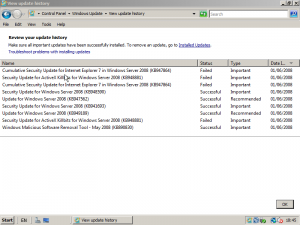

i updated the guide
i test it and its wasnt good the system wont load up
cos the backup and Manifests dirs
but now its update-able but need to save the backup files of Iexplorer too to make it perfect
i checked how much space its save
32bit 800mb [ my windows dir is 1.6giga]
64bit 1600mb [ didnt test it cos dont have VT so i guess the install size would be 3giga from 4.4giga ofc my settings]
im not sure if its recommand to do on wim file cos there a files that wont delete [system use them]
the best is do updating and then remove them [so u wont need to guess what the backup files of Iexplorer ]
check picture to more info
