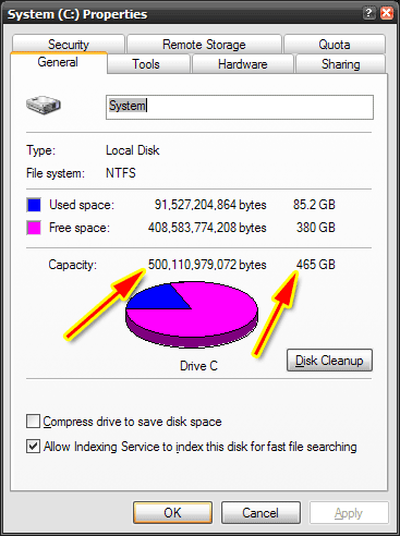

nmX.Memnoch Posted August 17, 2007 Posted August 17, 2007 the space you are loosing is normal for any hdd, search the forum, there are plenty of posts on it, the manufacturers dont advertise the actual space.Actually, they do...just not the "correct" way. Drive manufactures adversite:1,000 bytes = 1 kilobyteBut Windows (and all OSes for that matter) read:1,024 bytes = 1 kilobyteSee the attached screenshot. That's from two 250GB drives in RAID0. Notice that the capacity shows as 500,110,979,072 bytes. And that's correct. But when you divide it out that's roughly 465GB.500,110,979,072 bytes / 1024 = 488,389,628 kilobytes488,389,628 kilobytes / 1024 = 476942.99609375 megabytes476942.99609375 megabytes / 1024 = 465.764644622802734375 gigabytesSo you're not really losing space, it's just a difference in the way drive manufacturers present the information, and the way operating systems present it.So basically a drive manufacture tells you that 1,000,000,000 bytes is a Gigabyte. But all operating systems say 1,073,741,824 is a Gigabyte.As for the RAID problem, I'm not exactly sure what's going on. I wasn't aware that NVIDIA chipsets would allow you to target enabling RAID on specific channels. Unless you mean that you have RAID turned on, but only have it configured on those two channels (that'd make more sense)? The only thing I can think of is that you either don't have the array configured correctly or don't have something in Windows configured correctly.The "unknown" 300GB drive you're seeing is obviously one of the array members. The 600GB is the array itself. It sounds to me like the information isn't being passed from the RAID controller to Windows correctly.
