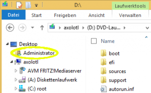

  2. Hi, I want to "declutter" the File Explorer default view a bit, reducing as many recent Windows 8.1 disimprovements as possible. As long as it could be done via Registry or tools like WENPCFG, I already did it. What's still bugging me is one entry (yellow border) for the current user. How could I remove it? Thanks in advance, Mikka
