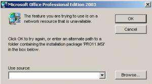

What if i put it in the same folder as office. Wont it detect PRO11.MSI automatically and continue? -
Update for Outlook 2003 Junk E-mail Filter (KB906173)
Nucleus posted a topic in Application Installs
I just downloaded the latest Update for Outlook 2003 Junk E-mail Filter (KB906173) Tried to install it, but got this window. It's supposed to be an administrative update. Why does it ask for the CD? How can i avoid this, so that i can make a silent install, using the /QB switch ? -

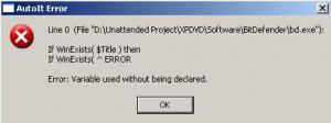

Example: ; Serial Number $SN_1 = "*****-*****-*****-*****" Run ( @ProgramFilesDir & "\Softwin\BitDefender8\bdmcon.exe" ) ; Splash Screen $Title = "BitDefender 8 Professional Plus - Evaluation" WinWaitActive ( $Title ) ControlClick ( $Title , "" , "Button1" ) ; Registration $Title = "BitDefender 8 Professional Plus - Registration" WinWaitActive ( $Title ) $SN = StringSplit( $SN_1 , "-" ) ControlSetText ( $Title , "" , "Edit1" , $SN[1] ) ControlSetText ( $Title , "" , "Edit2" , $SN[2] ) ControlSetText ( $Title , "" , "Edit3" , $SN[3] ) ControlSetText ( $Title , "" , "Edit4" , $SN[4] ) ControlClick ( $Title , "" , "Button1" ) ; Online #1 $Title = "Online Registration" WinWaitActive ( $Title ) ControlClick ( $Title , "" , "Button3" ) ControlClick ( $Title , "" , "Button2" ) ; Online #2 WinWaitActive ( $Title , "OK" ) ControlClick ( $Title , "OK" , "Button1" ) EXIT Most of the times, this script works just fine. But sometimes, it gets stuck, mostly on the ; Splash Screen window. Why? Because for some reason it becomes inactive. All it needs is just a click on it, so that it can become active again, and the script continues. Is there a way, to modify this script, so that if the window becomes inactive, it will force it to become active again, and continue the registration? Thanks
