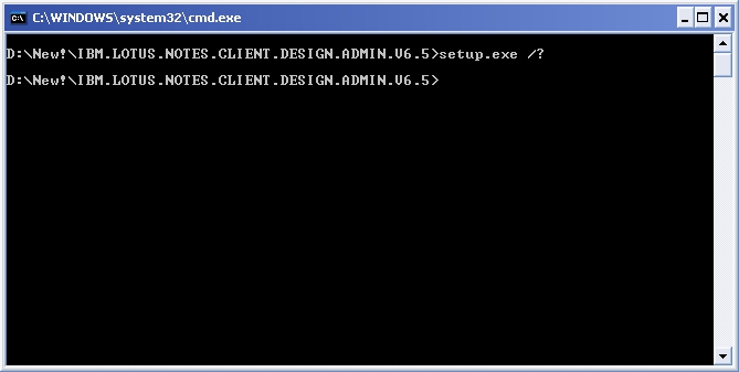

open cmd windows on installation folder & try setup.exe /? just for example open a cmd window in IBM.LOTUS.NOTES.CLIENT.DESIGN.ADMIN.V6.5 then type setup.exe /? as shown in attached shot:
