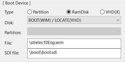

Do you happen to know the bcdedit commands needed to do this? I'm unsure how to add a PE wim file so it will boot. I have a partition for booting different vhds. Do I update the bcd from there to add the wim? Edit: OK, got it to work. I was missing the boot.sdi.
