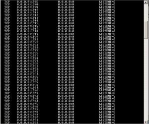

it is a service hiding under system32 and it only will triggle once u go online if u are not ONLINE <---- join public , it's like normal if u stay in private. identify the particural service and delete it. (unpack32.exe). So u need to apply the microsoft recemmemed tweak as fdv posted ( there is some more ) i can found it so i think there won't be a problem for u all Hope this help Best Regards to u all

Thx for your reply yes i have tweaked as microsoft recomemed anyway i have found a solution to resolve the problem now my server is running smoothly

Hi everyone my windows 2000 sp4 just been SYN Flood Attacked and it cannot go Online, once it go online the attack will happen again, i've already do serveral reg fix to remove this syn flood but cannot make it, my server got the most updated HF. anyone face this problem b4 ?? pls guide me . Thx in advance
