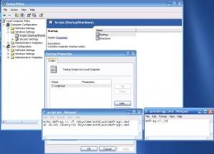

1boredguy Posted August 23, 2006 Share Posted August 23, 2006 Basically create a new gpo, in machine configuration, windows parameters, scripts, startup, and it's there that you'll put the batch script.This batch script must create the scripts needed to run the defrag and then add the task with the at command for example.Example for batchs that will create a batch file and then add the scheduled task:echo defrag c: /f >%systemroot%\autodefragc.cmdat 01:00 /every:01 %systemroot%\autodefragc.cmd This should work. Anyway i've never tried this, but this is the way i'll do things.OK. I kinda get the idea. I've attached a screen shot from an XP virtual machine (I will really be using it for Win2k server). Am I going in the right direction?Thanks Link to comment Share on other sites More sharing options...
allen2 Posted August 24, 2006 Share Posted August 24, 2006 You do not need to create autodefragc.cmd it will be created by script.cmd on each computer. Other than that, it should work. Link to comment Share on other sites More sharing options...

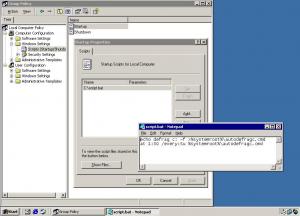

1boredguy Posted August 31, 2006 Share Posted August 31, 2006 (edited) You do not need to create autodefragc.cmd it will be created by script.cmd on each computer. Other than that, it should work.OK. I've done what you've said, and I've attached a picture of what I've got. I set it on my Win2000 Active Directory Server. I set the script in "gpedit.msc > Local Computer Policy > Computer Configuration > Windows Settings > Scripts (Startup/Shutdown)" But it doesn't go out to the whole network. There is a command to define a single remote computer...\\computername Specifies a remote computer. Commands are scheduled on the local computer if this parameter is omitted.So... The AT command is only setting the script to run on the local computer. I would like to schedule this for every computer in our network:at 1:30 /every:Su %systemroot%\autodefragc.cmd Edited August 31, 2006 by 1boredguy Link to comment Share on other sites More sharing options...
