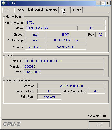

ripken204 Posted May 21, 2007 Posted May 21, 2007 well you dont need a pci card. your mobo supports agp 4x/8xhttp://www.newegg.com/Product/ProductList....amp;srchInDesc=

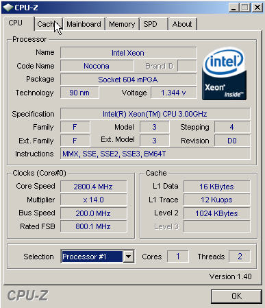

nmX.Memnoch Posted May 22, 2007 Posted May 22, 2007 I saw no mention of the problem being your video card. I'm going to assume you've tried all of the suggestions from that thread?- CHKDSK all drives, one at a time- Replace drive cables- Move the pagefileIf you've tried all of that have you swapped out the hard drive? Being that the problem appears to be somewhere in your drive subsystem that's where I would start if doing the above steps doesn't fix the problem. Short of that you are correct in that it's time to replace the motherboard.What are the exact details of the CPUs you have?

nmX.Memnoch Posted May 23, 2007 Posted May 23, 2007 Since you want to use the same RAM the closest motherboard replacement that I would recommend is the Asus NCCH-DL. The problem will be finding it for sale anywhere.
