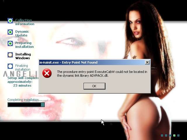

glentium Posted May 9, 2007 Posted May 9, 2007 (edited) We all know it's the replacement for KB928090, but it seems it's not yet supported by HFSLIP.. I'm having "ie4uinit.exe error with advpack.dll" something... am using HFSLIP 1.4.4HFSLIP.LOG.TXT Edited May 9, 2007 by glentium

glentium Posted May 10, 2007 Author Posted May 10, 2007 (edited) I got those errors during about T-25. It can be ignored but during first GUI boot it will appear again. I slipstream IE7 btw. Edited May 10, 2007 by glentium
Tomcat76 Posted May 10, 2007 Posted May 10, 2007 It isn't necessarily an error with ie4uinit.exe. Can you attach IEACCESS.IN_ from the SOURCESS folder?

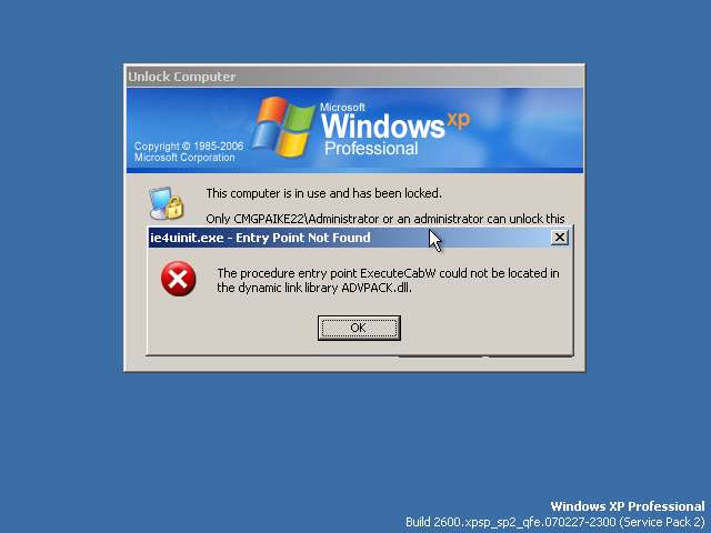

Kiki Burgh Posted May 11, 2007 Posted May 11, 2007 (edited) hi TC & glentium! i got the same error too which happened at 2 different instances:strange since the other night i tried it but with some of the other ie7 supposedly superceded by 931768 still included (as identified here: Support for hotfixes not appearing on Windows Update) ... yet everything went well without this specific error ... it could be something else ... i've attached too HFSLIP.log from both runs ... i also tried to see integrated HFs by using Kel's Windows Update List CPL addon NirSoft's WinUpdate List & it shows nothing of 931768 ... attached the result too ... thanks! btw, as a result too, ie7 was not installed ...logs.7z Edited May 11, 2007 by Kiki Burgh

Kiki Burgh Posted May 11, 2007 Posted May 11, 2007 thanks for this Veranor ... it's truly odd since i had both root cert & 931768 in prev run & this error didn't come up ... oh btw, i forgot to mention in my prev post that as a result too, no IE7 was installed ...
