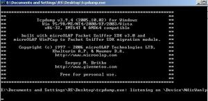

dexter.inside Posted April 8, 2007 Share Posted April 8, 2007 (edited) I use TCPDUMP.EXE, get it from my siteWatch carefully this picture:Notice the 9 incoming arp who-has packets that got received almost instantaneously. As this is only a minor problem on my Intel 10/100/1000 Pro on Windows 2003 CCS, because it is designed to handle much more traffic. But i'd say on a standard Realtek 100 Mbps LAN that could cause a lot of stress for Windows XP. I have no ingoing/outgoing traffic to those IPs. My svchost just keeps informing me of their existence in the same area (most are neighbors using the same ISP) for no apparent reason. The network is specifically configured so that none of those computers is discoverable, but, as you can see... my windows is discovering them.At a first glance, I'd say the network equipment from my ISP gateway is erroneously configured. But, the interesting point is that on the underlying VMware ESX Server 3 they do not occur. For some strange reason, the nLited Windows 2003 CCS gets these sent through the infrastructure's simulated network address translation. Neither does this happen on TCP/IPv6.There is no reason for those IPs to constantly poll me with their existance through ARP. But it seems it does. So, the logical explanation would be that one of the svchost processes is causing them. And it is bugging me for some time (psychologically), because I can't find any apparent reason for the TCP/IPv4 stack to behave this way other than svchost gone haywire. Edited April 8, 2007 by dexter.inside Link to comment Share on other sites More sharing options...

Madhits45 Posted April 10, 2007 Author Share Posted April 10, 2007 Dexter.. Ok I cant figure this thing out. I run TCPDUMP.exe and it does nothing I ran it for like a hour and nothing changes on the screen. Says listening to device <bla bla bla> but nothing happens. How does this thing work?I read the instructions and it seems like you dont have to do much if you have only one network connection running. Link to comment Share on other sites More sharing options...
dexter.inside Posted April 11, 2007 Share Posted April 11, 2007 1) yes, I do have the latest drivers & stuff2) I just run TCPDUMP and it outputs what happens on my network connection. You might have removed something that prevents it to do that job. You don't have to do something to make it work, it just does. I presume you do have network activity... Link to comment Share on other sites More sharing options...
Madhits45 Posted April 12, 2007 Author Share Posted April 12, 2007 Yeah I'm lost I tried this on my nlited box and now on my none nlited box and all i get is the following. I have left it running for hour again.Must be something I'm missing. Link to comment Share on other sites More sharing options...
dexter.inside Posted April 12, 2007 Share Posted April 12, 2007 try disabling that and it will listen on normal ethernet instead. Link to comment Share on other sites More sharing options...
Madhits45 Posted April 13, 2007 Author Share Posted April 13, 2007 try disabling that and it will listen on normal ethernet instead.Disable What? I had just run the program after extracting it. I only have one network connection enabled in device manager. Link to comment Share on other sites More sharing options...
dexter.inside Posted April 13, 2007 Share Posted April 13, 2007 well, that's certainly not good... maybe you've removed something that's preventing it work Link to comment Share on other sites More sharing options...
