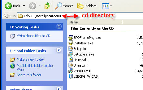

i have same issue....please help...i have been search through the forum but can not find the solution.
my config file is
pn=1;
prog[pn]=['Mcafee VirusScan Enterprise 8.0'];
uid[pn]=['MCAFEEVIRUSSCANENTERPRISE'];
dflt[pn]=['yes'];
cat[pn]=['Security'];
forc[pn]=['no'];
cmd1[pn]=['%wpipath%\\Install\\McAfee80\\msiexec.exe /i "VSE800.msi" /qb'];
pn++;
the file is under WPI\Install folder
