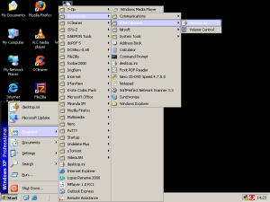

in the meantime i switched to nlite 1.3 final and have another problem, desktop.ini files appearing in my start menu
any clues ?

there are many desktop.ini files in C:
desktop.ini, a config file for each folder the desktop.ini file is in
Uncheck "Show system files" in Folder options
yup
  • Author
i unchecked it, the problem still persists
i found out that my old winnlite installation doesn't have those desktop.ini files lying around in C:\Documents and Settings\admin\Start Menu
so how can i get rid of them, what is causing them to appear on the first install of windows ?

help, my problem with desktop.inf files in the start menu still persists, any further help please ?
Just search for all desktop.ini, set all as hidden?
Hide hidden files.......
Or delete desktop.ini, not actually needed
I would only keep the ones in C:\WINDOWS
  • Author
yes, i can do that, i did that, that's not the issue; the problem is why does it keep doing that with my nlited xp ?
maybe there's some addon responsable ? i have no idea
