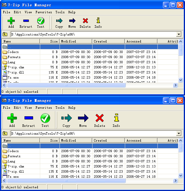

NetCobra Posted March 7, 2007 Posted March 7, 2007 (edited) To made 7Zip File Manager support Multi-Color toolbar image, you need just change one line code:File name: 7zip\FileManager\App.cppLine 152, Change original code imageList.Create( LargeButtons ? 48: 24, LargeButtons ? 36: 24, ILC_MASK, 0, 0);to imageList.Create( LargeButtons ? 48: 24, LargeButtons ? 36: 24, ILC_COLORDDB | ILC_MASK, 0, 0);Then compile it, you will get a your own edition with Multi-Color toolbar support.The attachment is the result I compiled, and I replaced the image of "Add" and "Test" button with Multi-Color image to show the affect. Just download and replace the official 7ZFM.exe with this one.I hope that someone could create a beautiful file manager by multi-color images Enjoy it!7zFM_Support_MultiColor.zip Edited March 7, 2007 by NetCobra

NetCobra Posted March 9, 2007 Author Posted March 9, 2007 The compare of my source hacked edition and the edition from http://highspeedbuilds.110mb.com/phpbb2/viewtopic.php?t=2
bledd Posted March 10, 2007 Posted March 10, 2007 this is what it looks like without the high colour patch, i might try and modify these to only include low colours if i can't find a way to change the current 7zfm
