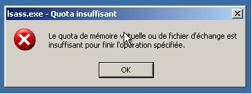

Dr_Z Posted March 29, 2007 Posted March 29, 2007 Hi !I have the same problemI'm using Win XP Home SP2 - FrenchNlite 1.3.0.4 FinalI tried to only put hotfixes from MS (on march 29th 2007), and NOTHING else. Here is the list of the 108 updates I used :And at the first reboot... virtual PC reboots, and reboots,... So i used "print screen" to have this **** error, just before reboot !The error, in french:The english translation would be :the quota of virtual memory or file of exchange is insufficient to finish the specified operation I really don't know what's wrong. I didn't even try "funny" stuffs ! I'm gonna keep on searching, but any help, idea, or advice would be welcome !
Dr_Z Posted March 29, 2007 Posted March 29, 2007 (edited) Hoora !Found the solution !there were 3 updates which where displayed as .CAB in Nlite.I took them offIt works !I hope this could help some of you Edited March 29, 2007 by Dr_Z
