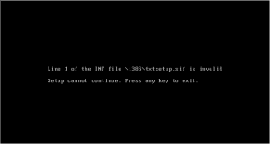

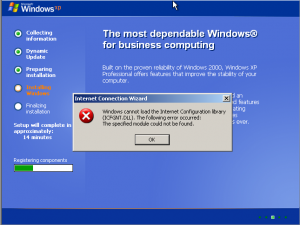

Pistolero Posted January 17, 2007 Posted January 17, 2007 (edited) Hi Nuhi,I have been experiencing this exact same issue with every 1.3 release to date (please look at screenie for more info). Once this happens, you end up with an empty desktop upon first logon and no apps work at all.It always happens at the same spot. Please note, however, that this same setup (only with RyanVM's 2.15a update as the new 2.16 doesn't work with older nLite versions anymore) works flawlessly when I nLite with version 1.0.1.I hope this helps get this bug squashed once and for all. Also, there appears to be an issue with the built-in ISO creator as it also always gives me the error about the invalid line upon CD boot. mkisofs seems to work fine, however.I am also attaching my Last Session INI file for reference.Thanks a bunch!LAST_SESSION.rar Edited January 19, 2007 by Pistolero

Pistolero Posted January 19, 2007 Author Posted January 19, 2007 w00t! I found the mahfah that was hosing my installs! Nuhi... how does 1.3 handle frakked-up INIs from AddOns? Take a look at this and see if you can tell what's wrong with the picture:############################################# Flash 9.0.16.0 Update by: 5eraph #############################################[general]builddate=2006/07/04description=Macromedia Flash Player 9.0 r16 for Internet Explorerlanguage=Englishtitle=IE Flash Updateversion=9.0.16.0website=http://www.macromedia.com/software/flash/about/That's it! Nothing more! No entries for the files included in the pack!The ideal behavior here would be for nLite to just ignore broken addons like this one, instead of trying to integrate them anyways... my guess is that this addon was causing invalid lines in the txtsetup.sif file or somewhere else, and that was preventing Internet Explorer from being installed, and that's where the ICFGNT error comes from.So, as promised, I give you a killer: http://www.esnips.com/doc/b1ac5709-2c7e-4b...Flash9R16_AddonThanks for looking into this, Nuhi!
