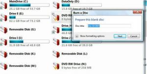

GordyBoy07 Posted December 20, 2007 Posted December 20, 2007 I have a Samsung that I installed after installing Vista. I do not have any problems.I don't understand the nature of the problem. The only person who described this problem is post #1 and everybody else said they have a similar problem but no one had clearly described the problem with screenshots.The issue happens when you try to read a disc in the dvd/cd player. Even though it is a good disk you get a popup box like shown below (I hope the picture is there. This is a random problem and appears and disappears. I have found that if you go to My Computer and right click and pick eject and then close the drawer, the disc is readable again but when you have to do a two disk install it may fail on the second disk and that is a real pain in the you know what.
