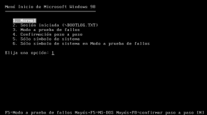

Great work Petr, italian Q311561 works perfectly on my 98SE during boot with entries of menu localized! :P
Thank you. :)
