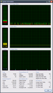

November 22, 200619 yr Author The two IDE channels have DMA enabled, although only a DVD drive is attached there. The three hard disks in the system are SATA and are running well. Please keep in mind this is something that has suddenly started to happen. I've been using this computer for more than one year with no issues. The Windows install is fresh and it worked fine for a couple of days before this behaviour appeared.I'm uploading both the text file in WinDbg and a capture of the Process Explorer graphs. Can you see the peaks in the graph? That' the services.exe every 6 seconds. (Learning from the graph I can see the 6 seconds interval gets longer every now and then, but most of the time it's a steady beat).Right after Windows installation, the system used to idle between 0% and 2%. Now it never goes below 3% (I can't see 0% anymore, not even once in a while).Here's what I see inside the WinDbg windows:Microsoft (R) Windows Debugger Version 6.6.0007.5Copyright (c) Microsoft Corporation. All rights reserved.Loading Dump File [C:\WINDOWS\MEMORY.DMP]Kernel Complete Dump File: Full address space is availableSymbol search path is: SRV*c:\websymbols*http://msdl.microsoft.com/download/symbolsExecutable search path is: Windows XP Kernel Version 2600 (Service Pack 2) UP Free x86 compatibleProduct: WinNt, suite: TerminalServer SingleUserTSBuilt by: 2600.xpsp_sp2_gdr.050301-1519Kernel base = 0x804d7000 PsLoadedModuleList = 0x805531a0Debug session time: Wed Nov 22 21:34:43.562 2006 (GMT+1)System Uptime: 0 days 0:54:37.132Loading Kernel Symbols.................................................................................................................................Loading User SymbolsLoading unloaded module list..................................................******************************************************************************** ** Bugcheck Analysis ** ********************************************************************************Use !analyze -v to get detailed debugging information.BugCheck E2, {0, 0, 0, 0}Probably caused by : i8042prt.sys ( i8042prt!I8xProcessCrashDump+237 )Followup: MachineOwner---------kd> !analyze -v******************************************************************************** ** Bugcheck Analysis ** ********************************************************************************MANUALLY_INITIATED_CRASH (e2)The user manually initiated this crash dump.Arguments:Arg1: 00000000Arg2: 00000000Arg3: 00000000Arg4: 00000000Debugging Details:------------------BUGCHECK_STR: MANUALLY_INITIATED_CRASHDEFAULT_BUCKET_ID: DRIVER_FAULTPROCESS_NAME: IdleLAST_CONTROL_TRANSFER: from f754e7fa to 804f8925STACK_TEXT: 80548d38 f754e7fa 000000e2 00000000 00000000 nt!KeBugCheckEx+0x1b80548d54 f754e032 00c0f0d8 0190e0c6 00000000 i8042prt!I8xProcessCrashDump+0x23780548d9c 8054071d 85904b20 85c0f020 00010009 i8042prt!I8042KeyboardInterruptService+0x21c80548d9c f758dc46 85904b20 85c0f020 00010009 nt!KiInterruptDispatch+0x3d80548e50 80540cc0 00000000 0000000e 00000000 processr!AcpiC1Idle+0x1280548e54 00000000 0000000e 00000000 00000000 nt!KiIdleLoop+0x10STACK_COMMAND: kbFOLLOWUP_IP: i8042prt!I8xProcessCrashDump+237f754e7fa 5d pop ebpSYMBOL_STACK_INDEX: 1FOLLOWUP_NAME: MachineOwnerMODULE_NAME: i8042prtIMAGE_NAME: i8042prt.sysDEBUG_FLR_IMAGE_TIMESTAMP: 41107eccSYMBOL_NAME: i8042prt!I8xProcessCrashDump+237FAILURE_BUCKET_ID: MANUALLY_INITIATED_CRASH_i8042prt!I8xProcessCrashDump+237BUCKET_ID: MANUALLY_INITIATED_CRASH_i8042prt!I8xProcessCrashDump+237Followup: MachineOwner---------CM
