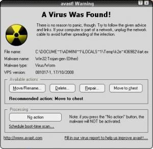

SmokinXP Posted October 18, 2008 Posted October 18, 2008 (edited) Downloaded RAID_Slipstreamer_v5.3_Build_080626.exe from link on page 1.Ran "C:\Temp\xp-unattended-intel-s5000pal\RAID_Slipstreamer_v5.3_Build_080626.exe "RAID Slipstreamer x86 v5.0 Build 071116.exe" /install /source C:\Temp\xp-unattended-intel-s5000pal /os 2003 /quick"Avast v4.8 with VPS version 081017-1 detects Win32: Trojan-gen {Other} in ..\%userprofile%\Temp\...\fart.exeSee attached jpgTried download again, same result!Where can I find a non-infected version?Is this a false positive?Any other suggestions? EDIT:Same deal with RAID_Slipstreamer_v5.2_Build_080104.exe .... Edited October 18, 2008 by SmokinXP

evila Posted December 17, 2008 Posted December 17, 2008 (edited) I encounter the same trojan warning too. Edited December 17, 2008 by evila
