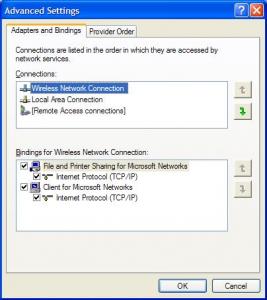

Check the advanced network settings on the laptop for correct bindings etc.:
