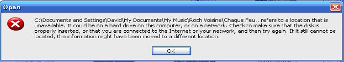

shades Posted August 3, 2006 Posted August 3, 2006 I was recently using Musicmatch to copy music to my hard drive. The program autoruns and when I hit the "copy" button, it creates its own directory under My Music. On one of the last CDs I copied, I believe I may have removed the CD from the drive before everything was created. Now I received the following message, which I have attached. Basically, it says that the location is unavailable and to check to make sure that the disc is properly inserted.I have already tried restarting the computer and that did not work. All the other directories in this folder work. It is just this one. Is there a way to delete it? When I tried to delete the folder, it would not work. Any suggestions?

shades Posted August 3, 2006 Author Posted August 3, 2006 I downloaded the program and when using it, it tells me that nothing is locking up the directory but that it can still help me deal with it. I selected Delete and OK. I received a message that the folder was deleted with success. However, the directory was still present and when clicking it, I get the same error message as before. What am I doing wrong? Perhaps another program would work better. I don't know. You can use unlocker to delete files that are locked by another process or are unavailable to access from any other reason with Unlocker app..Unlocker is freeware and you can get it here.

shades Posted August 4, 2006 Author Posted August 4, 2006 You can also kill explorer by going to task manager and choose explorer.exe and kill it, then try to delete the files using the command line while explorer not running.I tried this and got a "The system cannot find the file specified" response. I read somewhere that I might be able to delete this problem folder in Safe Mode. Is this correct? If anyone has other ideas, let me know. If I can't delete, so be it, I guess. I'm a little unsure about doing a system restore. I think I may have done that one time but with someone's assistance. I certainly do not want to mess up my computer just because of one insignificant folder. I want to find the most effecient and safe way to remove this folder. Thanks,David
