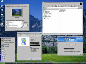

I'm attaching a pic to show what this can do...it's from the same version that's available. This is from my laptop running W2kSP4, with XPize 4.0 installed (go to the thread in the XPize forum about running it on W2k to see how to do this).
