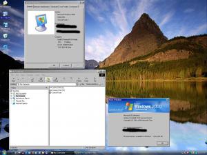

Here is a current screenshot I just took on my laptop: it's running Win2k SP4, with XPize 4.0 installed, and using the Vista 1.4 WB skin found on joejoe's site.
I'm experiencing some sort of glitch with this where it doesn't attach itself to the taskbar when refreshed. I'm not sure why, but it might have something to do with having nLited my comp?
tClock2 and tClockLite don't do it though, so...did you make any changes to how it interfaces with explorer? :huh:
With the previous version it didn't auto-refresh, so I could start it up, apply settings, then start it up again to see the results. Oh, and every time it refreshes the taskbar, the process becomes "dead" and stops doing stuff(except using 6mb memory). I managed to get about 10 of them before I noticed and killed all the dead ones. :D

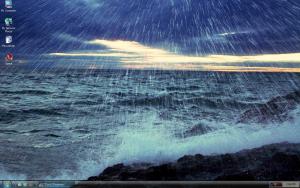

But I still don't know how to skin the clock. Could you post your .bmp or .tga for the clock and settings in
TClock3 Properties?
Cool, thanks. I am going to leave it on the laptop from now on... looks not so the same anymore. :D

Try setting the sizing margins to 4, 14, 4, 15 for left, top, right, and bottom, respectively. Do this for all of the full skinning tabs as well as the tray/clock fill tab. Where did you get the skin? It looks like your files are different from mine (for instance, my quicklaunch file is a .tga, and all of my files start with "48px"). If I can get yor skin files I can test it to see what's going on. I have my taskbar alpha set to 160, as well as for my clock setting (though that shouldn't matter).
On the taskbar page (not the full skinning one), make sure everything is set to "normal" and that everything is unchecked. I doubt it matters, but it's what I have. We'll get it -- there's a trick to getting the clock to paint, but we'll get there.
Tried the suggestions, and no :(
Ya....I modded a few :P So it is probably something I did, ooops.
