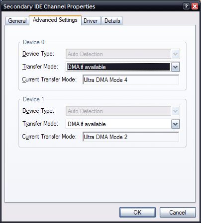

nmX.Memnoch Posted December 6, 2005 Posted December 6, 2005 (edited) 1. Are both drives UDMA capable? If you have one drive that is and one that isn't I think it drops to the slowest of the the two.It used to be that way back in the day but with newer boards you can have the drives running at different speeds. For example, I have a Pioneer DVD burner that does UDMA-4 and a Sony CD burner that does UDMA-2. They're both connected to the same channel and each doing their own respective speeds. Edited December 6, 2005 by nmX.Memnoch
m16si Posted December 6, 2005 Author Posted December 6, 2005 Thnx Now i have Ultra DMA 5 for HDD'sBut how can i change MODES for DVD-RW and DVD-ROM they're both under Multi-word DMA 2 !!!DVD-RW is a brand new NEC-4550DVD-ROM is also newThey both support mode 5 but how can i change it ?Thnx
