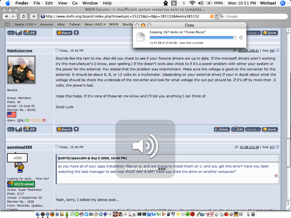

I am currently copying all my songs from G:\ to my iBook's 60GB drive (see screenshot)... No problems as of yet. I'm also running Memtest on the computer to check for RAM problems...
