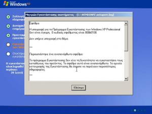

n7Epsilon Posted August 7, 2005 Posted August 7, 2005 You will get the error in attached image if you for some reason edit LAYOUT.INF...It can also happen from corrupt media...
