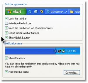

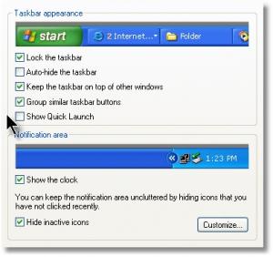

Trouble is guys here is some screen shots (only whats needed to be set)
its not a matter of how big the quicklaunch bar is but a default one like this that can be set in hundreds of systems if needed
clip1 to clip5 is what we normally do
clip1 is nobar at all
clip2 is properties to turn it on
clip3 is now turned on
clip4 is the default icons which are crap (should be like in clip5)
clip5 is how a standard setup should be
so can someone do it
I have done so many edits the registry has failed 3x times and I had to reinstall windows 2x
anyway thats all I can say I am stumped
thanks
best way is, arrange the quicklaunch with thatever links you want there and export the below regs and apply during install. This is one of very very few successful way which works everytime.
