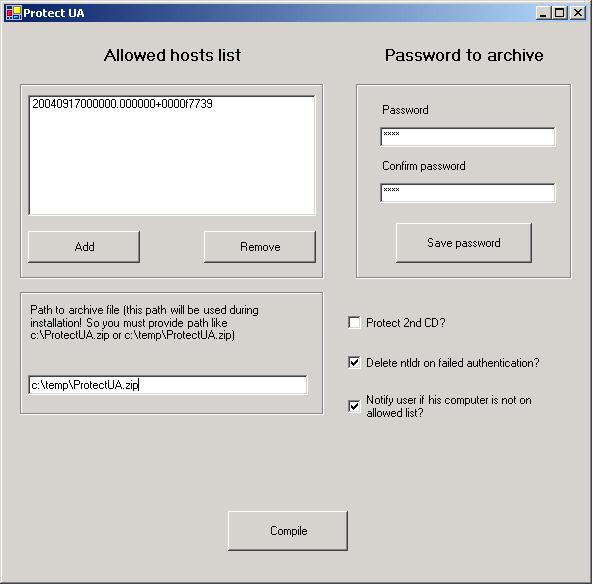

rikgale Posted July 25, 2005 Posted July 25, 2005 Looking good Martin! Looks smart and unclutered, which is a good thing.I see that you have allowed check boxes for Msg pop up and protecting 2CD. Can I suggest that in a beta release that you have a pop-up box that when you hover the mouse over check box, explains what it is for. Try and make it id*** proof as possible. Becuase 2CD is a bit ambiguois. You, I and Moon know what it means, but does/will everyone else?
Martin Zugec Posted July 25, 2005 Posted July 25, 2005 Yep, I am planning to implement tipboxes for every selection... Because if someone dont know what does it mean, it is not self-explanatory.
