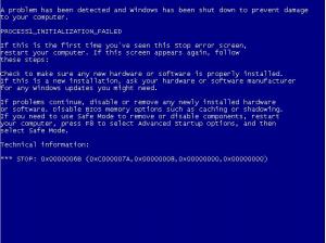

PROCESS1_INITIALIZATION_FAILED
You are going to have to give us more information than that. When does this happen. Does XP install and this shows up afterwards? Does this show up before the installation begins?

ok.
here some more information:
i reccive that massege after the install load the drivers
and before the HD setup comming up..
i have put in the WINNT.SIF

by the way- i have some news -
the problem was on the ntoskrnl.ex_ and the ntkrnlmp.ex_ files
somehow this files was failed the install.. waht i was doing and have i solve
that problem?
here is the anware:
i take from another cd (UN-ED from my friend- are work perfect)
and in his I386 - i take the file "ntkrnlmp.ex_" and comprees to "ntkrnlmp.exe" and i put that file (only!!) in the I386 folder
and i remove the ntoskrnl.ex_ and the ntkrnlmp.ex_ files
and im solve that problem!- now i have the same massege on the start
of GUI setup.. U can see at this topic:
