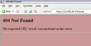

Ok guys not sure about this one:
When i use RDP i enter the IP address, username, password and domain - i am successfully logged in.
If i go to a website and type in http//:IP_Add/tsweb it doesnt recognise anything and brings up page cannot be found. How come am i doing something wrong?
My router is forwarding port 3389 to my server. So what seems to be going bonkers here?
Thanks
I tried https:// that came with the same problem.
Klasika - I have installed Remote desktop web client, i think that may be the same thing, if not could you give some instructions on installing terminal services web client please
Thanks
Another edit: Lets say i have changed the port from 3389 to 1234 - how should this be typed into the address bar or where do i input the new port?
This is the error that i see when connecting via web:
When you install IIS, there you can pick if you want TSweb client or not, and regarding port, if you have change it to lets say 1234 then you should configure your forwarding to forward RDP request to port 1234
