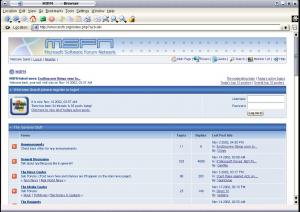

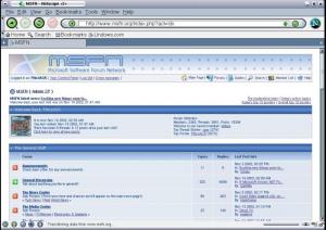

FthrJACK Posted November 14, 2002 Author Posted November 14, 2002 ya want more you will just have to look on the web for lindows.netscape:
