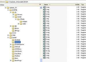

BritishBulldog Posted October 17, 2004 Author Share Posted October 17, 2004 Ok its nothing spectacular but it works.because XPlode.xml does not understand %CDROM% there had to be a way of getting this info before XPlode.exe started.my DVD was built up as below in the picture, all my programs are in an install directory direct on the root and not in %OEM% so they dont get copied the the hard drive.The main problem is getting the %CDROM%, so out of my cmdlines.txt i call up a findcd.cmd before XPlode is started.cmdlines.txt[COMMANDS]"konten.cmd""findcd.cmd"".\$1\Install\XPlode\XPlode.exe /xml:#Systemdrive#\Install\XPlode\XPlode.xml /log:#Systemdrive#\XPlode.log"the findcd.cmd contains the routine to find the CD/DVDfindcd.cmdcmdow @ /HID@echo offIF EXIST D:\CD.txt set CDROM=DIF EXIST E:\CD.txt set CDROM=EIF EXIST F:\CD.txt set CDROM=FIF EXIST G:\CD.txt set CDROM=GIF EXIST H:\CD.txt set CDROM=HIF EXIST I:\CD.txt set CDROM=IIF EXIST J:\CD.txt set CDROM=JIF EXIST K:\CD.txt set CDROM=KIF EXIST L:\CD.txt set CDROM=LIF EXIST M:\CD.txt set CDROM=MIF EXIST N:\CD.txt set CDROM=NIF EXIST O:\CD.txt set CDROM=OIF EXIST P:\CD.txt set CDROM=PIF EXIST Q:\CD.txt set CDROM=QIF EXIST R:\CD.txt set CDROM=RIF EXIST S:\CD.txt set CDROM=SIF EXIST T:\CD.txt set CDROM=TIF EXIST U:\CD.txt set CDROM=UIF EXIST V:\CD.txt set CDROM=VIF EXIST W:\CD.txt set CDROM=WIF EXIST X:\CD.txt set CDROM=XIF EXIST Y:\CD.txt set CDROM=YIF EXIST Z:\CD.txt set CDROM=ZREGEDIT /S %CDROM%\install\CDROM\%CDROM%.regok it can be shortened. when the CD drive is found then the coresponding .reg file is put into the registry through the last line.so if the CD/DVD was at f: then F.reg would be loaded to the registry, if it was g: the g.reg is loaded.I am sure there is another way of doing this without all the .reg files.F.regWindows Registry Editor Version 5.00[HKEY_LOCAL_MACHINE\HARDWARE\CD]"CDROM"="F:"G.regWindows Registry Editor Version 5.00[HKEY_LOCAL_MACHINE\HARDWARE\CD]"CDROM"="G:"all that is needed now is that XPlode.xml calls up the value from the registry.this is done before my first application is installed, the routine is below called Preparing CD ROM.- <item display="Preparing CD ROM"> <registry display="Reading CDROM" method="read" hive="HKLM" key="Hardware" item="CD" variable="CDROM" /> </item>So now instead of having everything copied to the hard drive they will install from the CD/DVD saving time.my XPlode.xml is below, it is not finished I am still having problems with the 'filecopy' and 'dircopy' so if any of you can give me tips they are appreciated.MS Office , Paintshop and WinAmp dont work at the moment but the others all do. Link to comment Share on other sites More sharing options...
