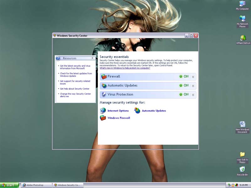

jada855 Posted October 11, 2004 Share Posted October 11, 2004 My fault on the errors sorry. Well my cpu FSB is set to 166mhz my ram is ddr pc2100 at 266mhz. In my bios I have the option to increase the cpu FSB speed to 248 max but the system will not start with anything above 166mhz for the cpu FSB.I can leave the cpu FSB at 166 and over clock the ram to 333mhz but i still have the re-draw problem. I have attached and image to show you how the sp2 security screen opens when no other programs are open. Things I have tried turning off all the GUI effects inside windows xp even the themes and I still have this problem here is my detailed system specs. And I know its not the Service packs it even happens on the fresh install of windows xp. here are my system specsMotherboard:kt600 pro by albatron via chipset (latest drivers)Nvidia geforce mx400 64mb agp 4x card(latest drivers)pc2100 ddr ram 256mb20gb hardisk 5400rpm(could this be the problem??) 2mb cache bufferMonitor IBM G70(even tried the resolution at 800x600 and a 100mhz refresh rate)I disabled the direct draw acceleration ( And to my suprise I saw some improvement)AMD athlonxp 2600+Barton core 512kb L2 cache Final theory could it be me because i built the systems everything seems to be running fine on the processor meaning I have a heatsync I used the thermal glue and the right fan speed.I think it just might be the ram I need to go ahead and get the pc2700 512mb of ram 256 is just not enoughIts funny I play games like unreal 2003 just fine with great frame rates and high textures no problem. But I do experience a super re-draw problem after I quit the game my desktop will re-draw super slow after I quit a game I think it has something to do with the hard disk because when the light is in use on the front of the case is usally when the slow down of the windows comes into playbut if anyone else has any solutions I am willing to try. I find it wierd because I thought I was the only one with this problem so I never mentioned it till i saw this post.I tried everything you recommended in the previous post.thanx for any help Link to comment Share on other sites More sharing options...
