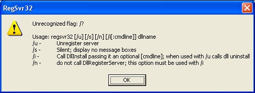

type REGSVR32 /? at a cmd prompt to see the switch - maybe you can add it.

I installed that speedup and I don't see that file in my System32. Could it be MSCOMM32.OCX or mscomctl.ocx you need. If so and you doing silent make sure you add the /s
regsvr32.exe MSCOMM32.OCX /s
