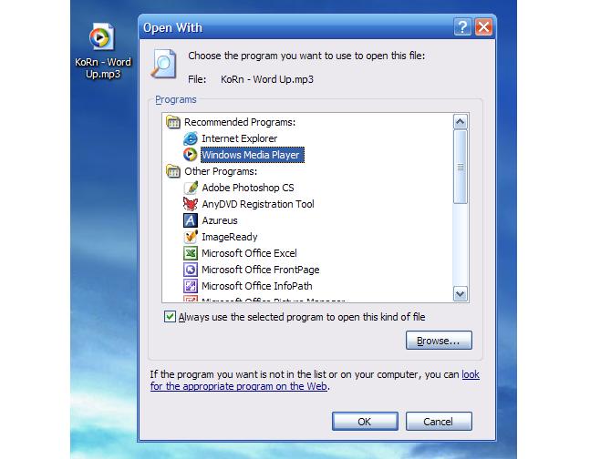

after doing an unattended install, for some reason whenever i click on an mp3 to play it it asks me what to open it with. i want my default player to be wmp9 and i don't want it to ask me that all the time. i try to click to make this the default program to open this file type, but its no use.
I think this is the registry key that is causing me problems:
[HKEY_LOCAL_MACHINE\SOFTWARE\Policies\Microsoft\WindowsMediaPlayer]
"GroupPrivacyAcceptance"=dword:00000001
I used the key so that I don't get that setup screen on the first run of wmp, but I think it is causing problems.
Can anybody help me fix this problem. I want to be able to click on an mp3 and have it automatically open with wmp 9.
Example: When I click an mp3 file this pops up no matter if I check the box "Always use the selected program....etc" box or not.
