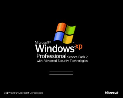

Astalavista Posted September 2, 2004 Posted September 2, 2004 oki downloaded a ntoskrnl.exe from themesxp.orgnow per Allanol instructions, i am using resource tunerto open the file and just copy the image file, but i can't find it.I have attached the image of what i downloaded.
Alanoll Posted September 2, 2004 Posted September 2, 2004 My instructions needed an understanding of the basics of kernel editing. Seeing as you didn't understand, I"m guessing your DON'T have that....Check the cometics thread for instructions.
jrzycrim Posted September 2, 2004 Posted September 2, 2004 Are you running SP2? Also, do you have a hyperthreading or multi-procressor system?
